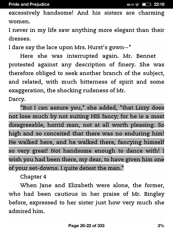

Is the text highlighted in gray like in the example below or is the text marked with a gray dashed underline? If it is underlined, then that is the Popular Highlights feature. Information about that also can be found via the link I cited above under "Viewing Popular Highlights."
